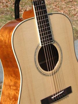

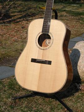

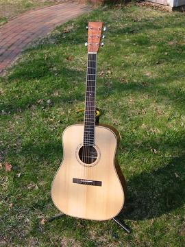

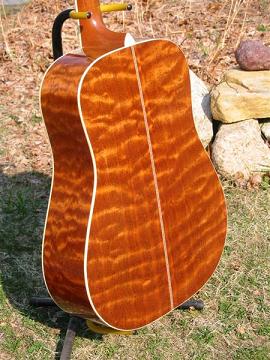

Thanks for looking, please forgive my terrible photos I am limited by my 2.1 mega ancient camera.
This guitar is Honduras mahogany with an adirondack top, brazilian finger board and bridge.
I started this guitar a long time ago, and at one point didnt even really want to finish it, Im glad i did now.
I will be bringing a few of my guitars down to the A.S.I.A. symposium. It will be the first time that I will be showing my guitars, and I am looking forward to meeting those of you who will be there very much.
thanks again,
Matt

Looks great Matt! Did you use anything to get that nice warm color in the mahogany, or is that natural?

I had the opportunity to see this guitar while it was in the spray booth. It's a very nice guitar.
Matt, these pics sure hide the Quazimoto asymmetrical bump in the treble side upper bout. Good photography!
PostPosted: Wed Apr 20, 2005 4:43 am
Posts: 556
Thanks Don,
Well now that the cat is out of the bag, about half way through the build on this guitar i noticed a slight discrepency in my home made body mold. So this one kinda hung around while I worked on some others.
I have since replaced my mold with one of John Halls D-28 molds, which I feel much more confident using.
After a few months of hemming and hawing, I decided to finish it up and keep it as a player for myself. I have not been able to keep any of my guitars and I literally have gone months with out my own guitar to play.
Other than that, the guitar really is light,loud and is awesome in terms of tone and playabililty. I wish i could pass it around to you all.
thanks for the kind comments.

To answer Dave`s question:
It is just natural color, I do use oil based filler which darkens and inhances the color some.
I like to apply filler and wipe it back with a rag just dabbed sligtly in naptha. This seems to enhance the hondurans color nicely.
I think of it as inking the wood.
thanks for asking.

Matt, mind if I ask what brand/color of grain filler you used?
I have a African Mahogany dred that I have had hanging up fo almost a year now because I just am not happy with the color. If I could get it the color of yours I might go ahead and put a neck on it and finish it up.
Thanks.
PostPosted: Wed Apr 20, 2005 9:46 am
Posts: 556
sure, i use good ole Constantines black paste filler.
